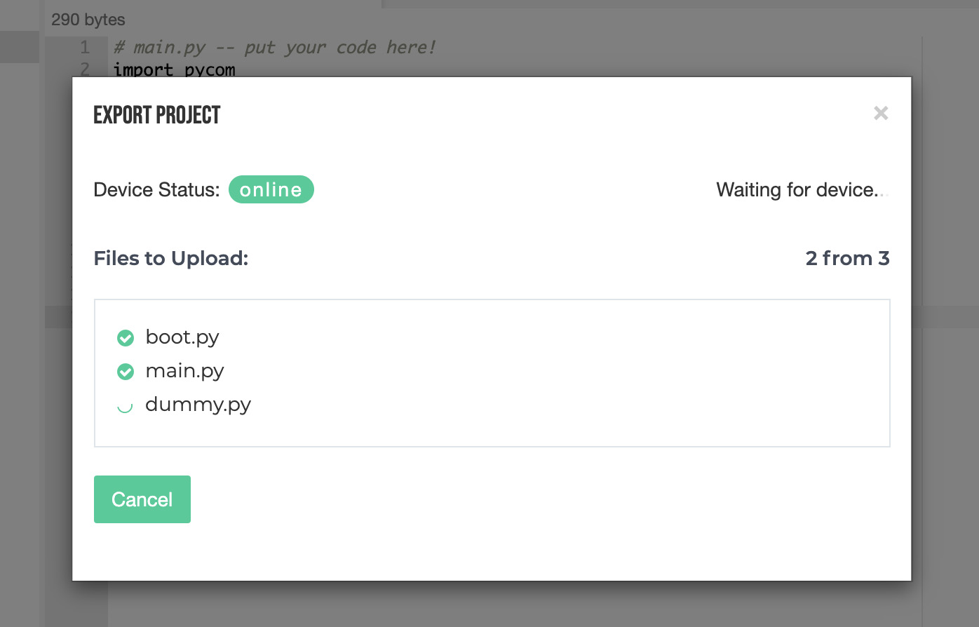

  • You can also export to a device. This modal will open after clicking on “UPLOAD TO DEVICE” button. Note that your device needs to be online in order to receive the files from Pymakr Online.
  • Wait while Pymakr Online is uploading your project to the selected device.

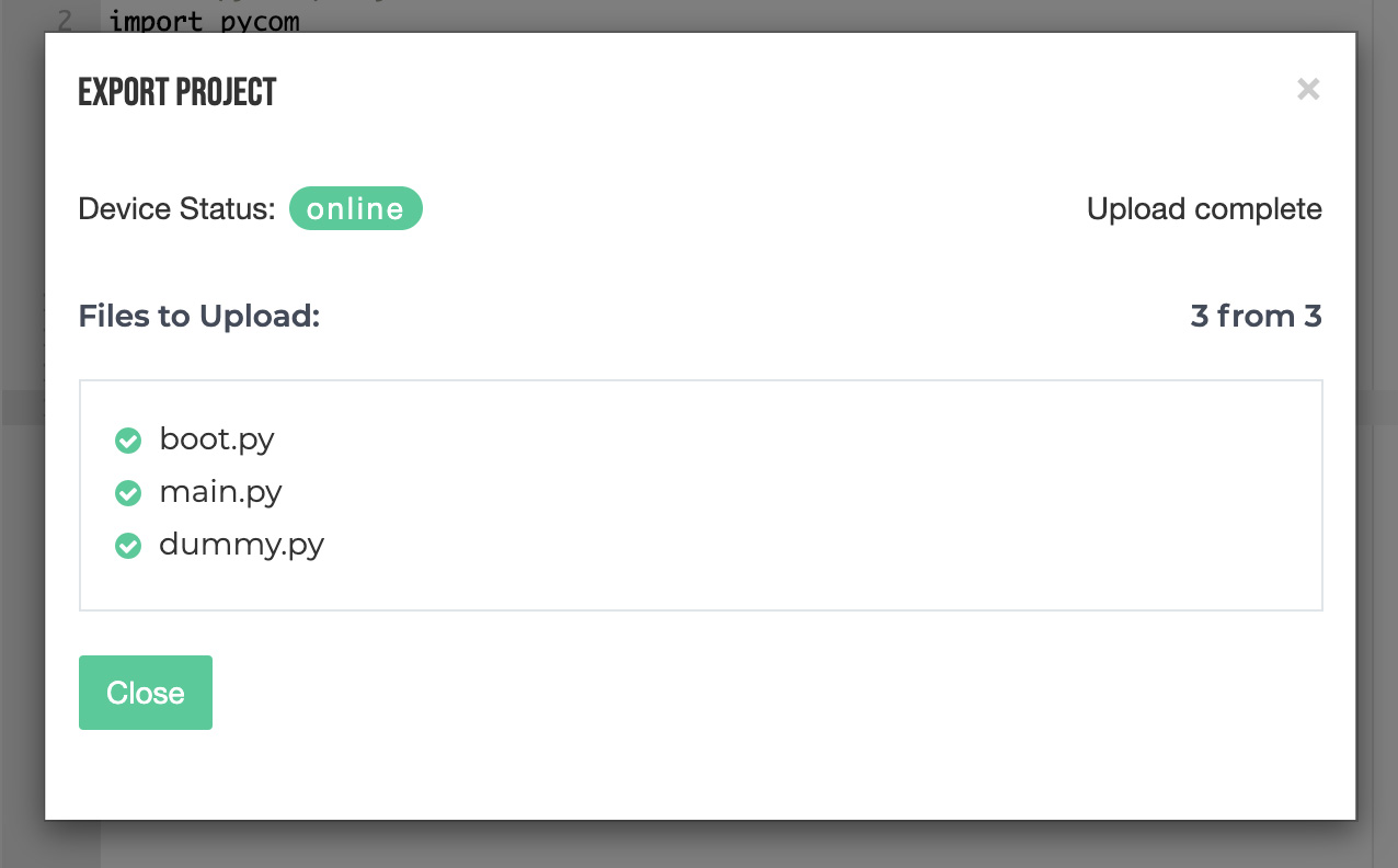

  • Once the upload is done, your device will restart and load the new code.
