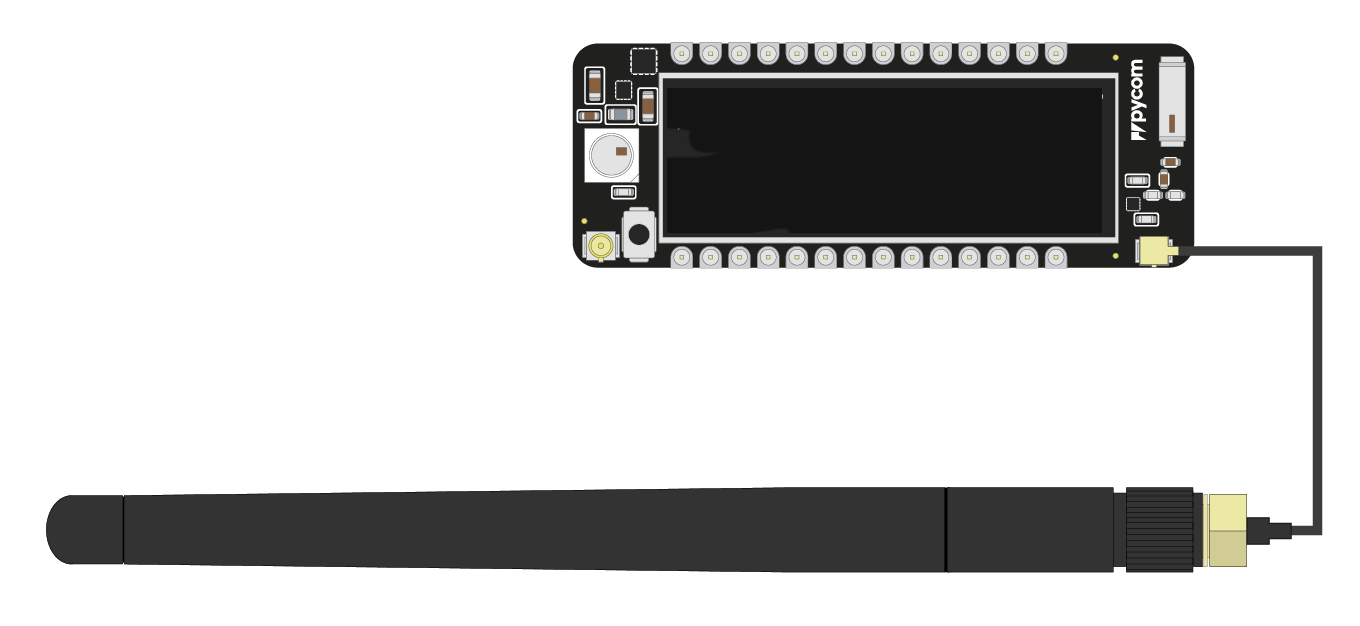

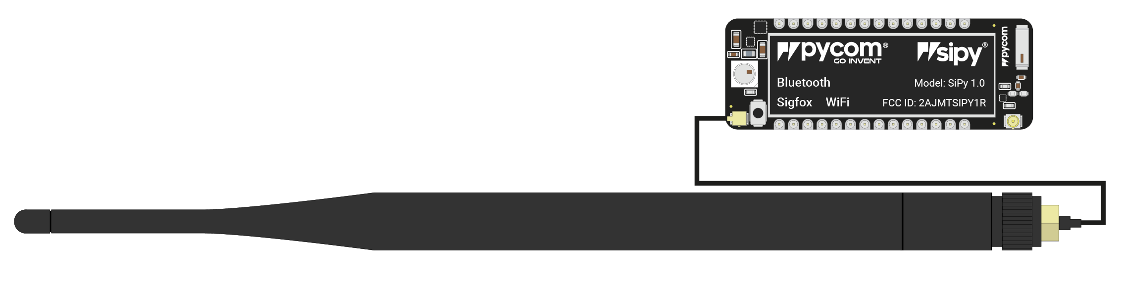

Antennas
Sigfox
If you intend on using the Sigfox connectivity of the SiPy you must connect a Sigfox antenna to your SiPy before trying to use Sigfox otherwise you risk damaging the device.
  • Firstly you will need to connect the U.FL to SMA pig tail to the SiPy using the U.FL connector on the same side of the SiPy as the LED.
  • If you are using a pycase, you will next need to put the SMA connector through the antenna hole, ensuring you align the flat edge correctly, and screw down the connector using the provided nut.
  • Finally you will need to screw on the antenna to the SMA connector.
WiFi/Bluetooth (optional)
All Pycom modules, including the FiPy, come with a on-board WiFi antenna as well as a U.FL connector for an external antenna. The external antenna is optional and only required if you need better performance or are mounting the FiPy in such a way that the WiFi signal is blocked. Switching between the antennas is done via software, instructions for this can be found here.
