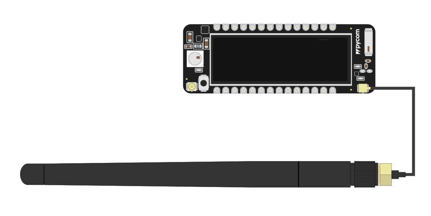

Lora antenna
If you intend on using the LoRa connectivity of the LoPy you must connect a LoRa antenna to your LoPy before trying to use LoRa otherwise you risk damaging the device.
The LoPy only supports LoRa on the 868MHz or 915MHz bands. It does not support 433MHz. For this you will require a LoPy4.
  • Firstly you will need to connect the U.FL to SMA pig tail to the LoPy using the U.FL connector on the same side of the LoPy as the LED.
  • If you are using a Pycase, you will next need to put the SMA connector through the antenna hole, ensuring you align the flat edge correctly, and screw down the connector using the provided nut.
  • Finally you will need to screw on the antenna to the SMA connector.

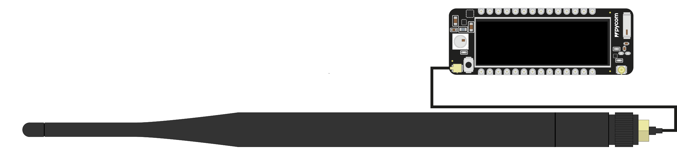

WiFi/Bluetooth antenna (optional)
All Pycom modules, including the LoPy, come with a on-board WiFi antenna as well as a U.FL connector for an external antenna. The external antenna is optional and only required if you need better performance or are mounting the LoPy in such a way that the WiFi signal is blocked. Switching between the antennas is done via software, instructions for this can be found here.
