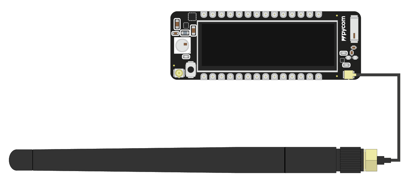

LTE Cat-M1/NB-IoT
If you intend on using the LTE CAT-M1 or NB-IoT connectivity of the GPy you must connect a LTE CAT-M1/NB-IoT antenna to your GPy before trying to use LTE Cat-M1 or NB-IoT otherwise you risk damaging the device.
  • You will need to connect the antenna to the GPy using the U.FL connector on the same side of the GPy as the LED.

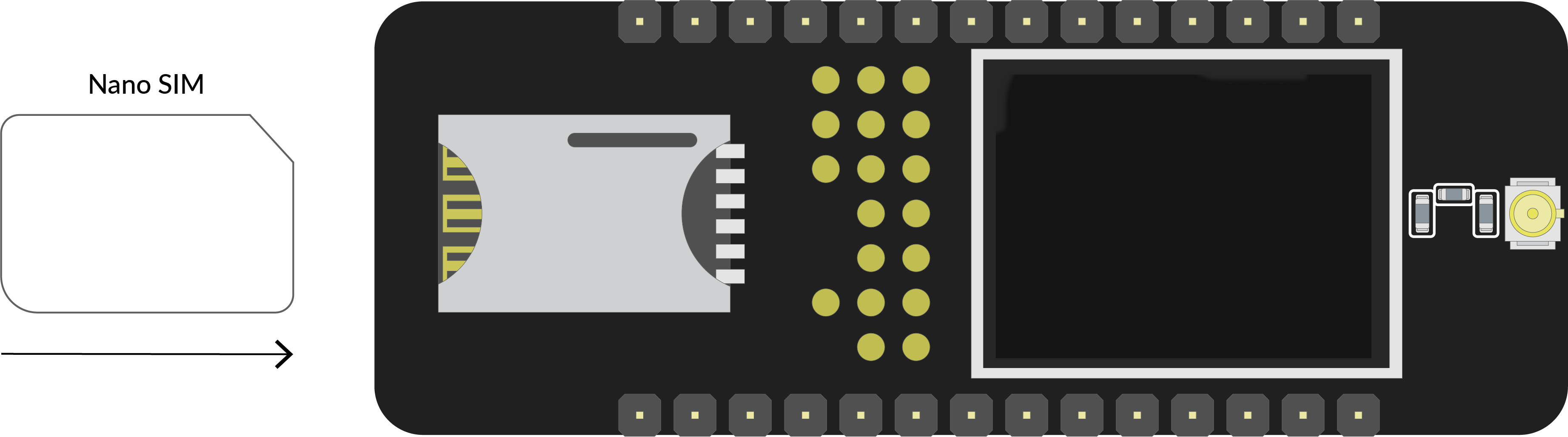

SIM card
If you intend on using the LTE CAT-M1 or NB-IoT connectivity of the GPy you will need to insert a SIM card into your GPy. It should be noted that the GPy does not support regular LTE connectivity and you may require a special SIM. It is best to contact your local cellular providers for more information on acquiring a LTE CAT-M1/NB-IoT enabled nano SIM.
