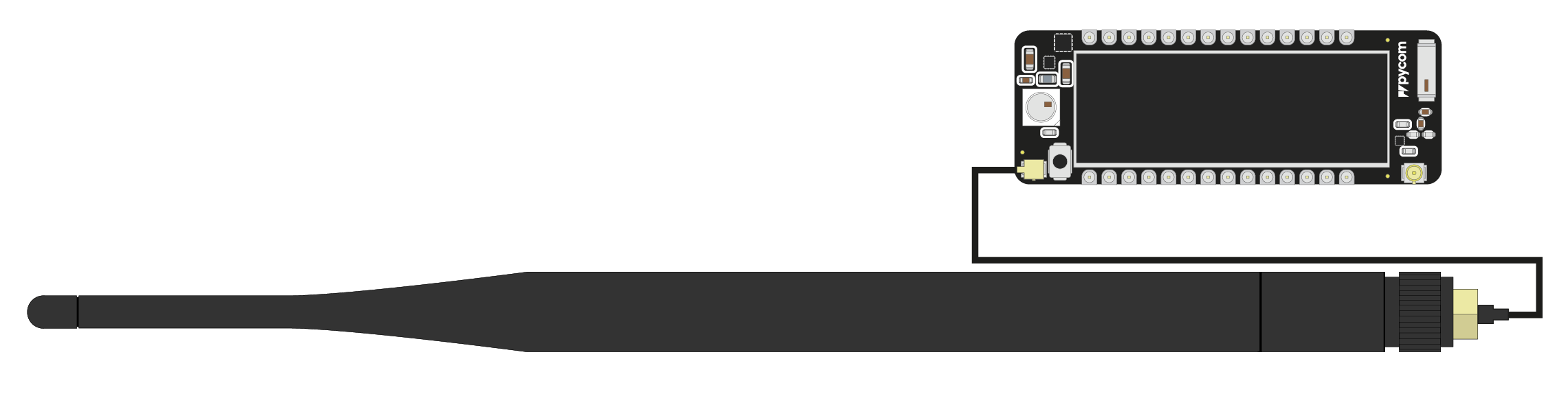

Lora/Sigfox
If you intend on using the LoRa/Sigfox connectivity of the FiPy you must connect a LoRa/Sigfox antenna to your FiPy before trying to use LoRa/Sigfox otherwise you risk damaging the device.
The FiPy only supports LoRa on the 868MHz or 915MHz bands. It does not support 433MHz. For this you will require a LoPy4.
  • Firstly, you will need to connect the U.FL to SMA pig tail to the FiPy using the U.FL connector on the same side of the FiPy as the LED.
  • If you are using a Pycase, you will next need to put the SMA connector through the antenna hole, ensuring you align the flat edge correctly, and screw down the connector using the provided nut.
  • Finally you will need to screw on the antenna to the SMA connector.

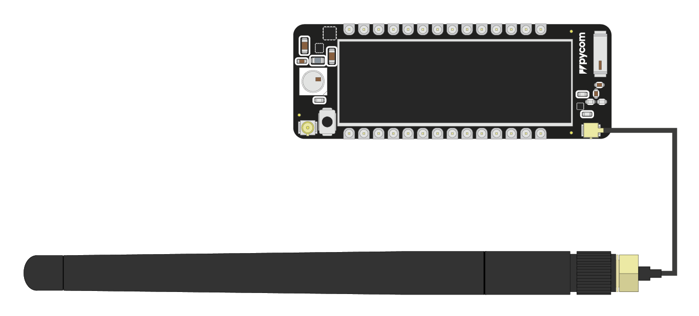

LTE Cat-M1/NB-IoT
If you intend on using the LTE CAT-M1 or NB-IoT connectivity of the FiPy you must connect a LTE CAT-M1/NB-IoT antenna to your FiPy before trying to use LTE Cat-M1 or NB-IoT otherwise you risk damaging the device.
  • You will need to connect the antenna to the FiPy using the U.FL connector on the under side of the FiPy.
